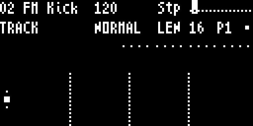

The Track Parameters screen configures the active track’s sequencer behavior — pattern type, length, arpeggiator, euclidean generator, gate time, and track speed. Access it by pressing FUNC3 three times from Sound.
FUNC3— cycle to Track Parameters (Sound → Track Mixer → Track)- ↑/↓ — switch parameter pages
- ←/→ — switch active track

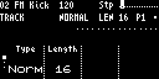

Page 1 — Type & Length
| Knob | Parameter | Values |
| Knob 1 | Type | Norm (normal), ARP (arpeggiator), EUCL (euclidean) |
| Knob 2 | Length | 1–64 steps |
| Knob 3 | (depends on Type) | See below |
| Knob 4 | (depends on Type) | See below |

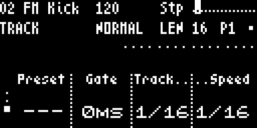

Page 3 — Gate & Speed
| Knob 2 | Gate (gate time) | 1–64 ms |
| Knob 3 | Track.. (speed top) | Fraction numerator |
| Knob 4 | ..Speed (speed bottom) | Fraction denominator |
Track speed is displayed as a fraction (e.g., 1/2 for half speed, 2/1 for double speed).

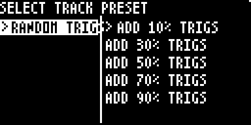

Track Presets
Shift + FUNC4 opens the Track Preset browser for loading pre-configured track setups.
See Macros & Presets for details.
