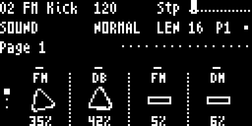

The Sound screen is the primary view for editing the active track’s synth engine. It displays four parameters per page, one per knob.
Sound screen — parameters page

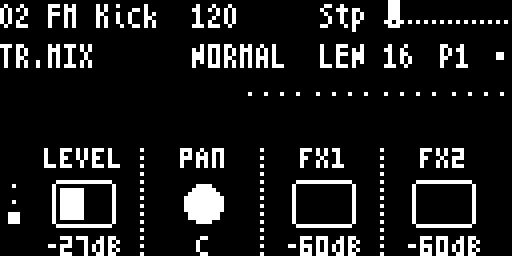

  • FUNC3 — enter Sound screen (cycles: Sound → Track Mixer → Track)

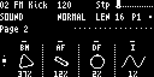

Parameter Pages
The number of pages, page names, and parameter names are defined by the loaded Macro. Different Macros expose different parameters. A typical preset might have pages like:
Page 2
Page 3
Page 4
Each page shows up to 4 parameters. The page name appears at the top of the screen, and page indicator dots at the bottom show your current position. Presets can have up to 6 pages (24 parameters).

    • Level / Volumeoff at the bottom, 0dB at unity (the default for most level knobs), up to +12dB at the top. Same fader curve everywhere — see Signal Flow for why this is consistent across track LEVEL, FX returns and Master Volume.
