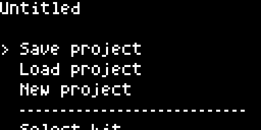

The Project menu manages saving, loading, and creating projects, as well as kit selection and track setup. Access it with FUNC1.
Menu Items
| Item | Description |
| Save project | Save the current project to SD card |
| Load project | Browse and load a saved project |
| New project | Clear all tracks and start fresh (with confirmation) |
| Select kit | Choose a sound kit (see below) |
| Change track setup | Load a track template (see below) |
| Settings | Open the Settings menu |
The title bar shows the current project name (or “Untitled” / “Slot N” if unnamed).
- ↑/↓ — scroll through menu items
- → or Knob 1 click — select/enter item
- ← — go back

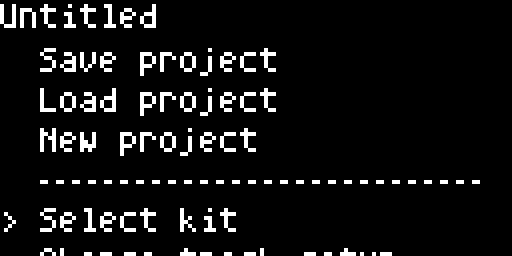

Select Kit
Opens a list of available sound kits. Each kit defines a set of sound engines and presets for all tracks. The currently active kit is marked with <. Select a kit and press → or Knob 1 to apply it.
