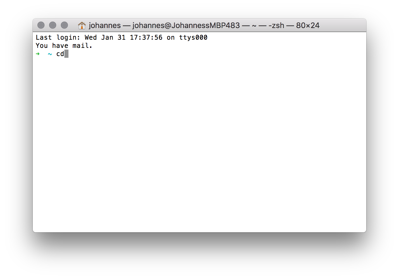

Type “cd” in the new Terminal Window, and add one SPACE after the two letters.
cd

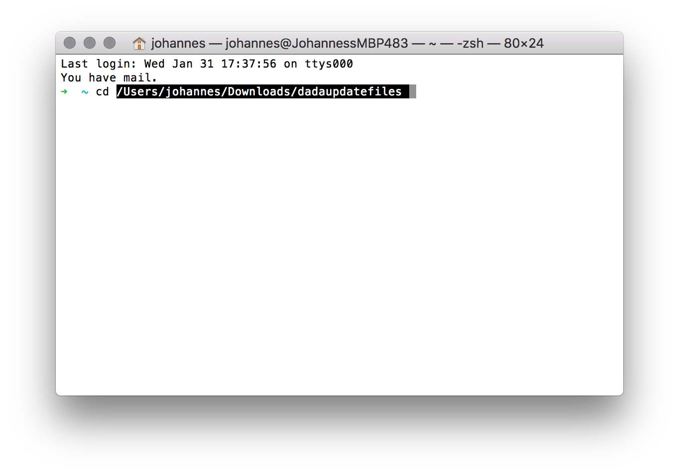

- Drag the Folder named “dadaupdatefiles” on the Terminal Window. What you see now should look similar to my the screenshot below.

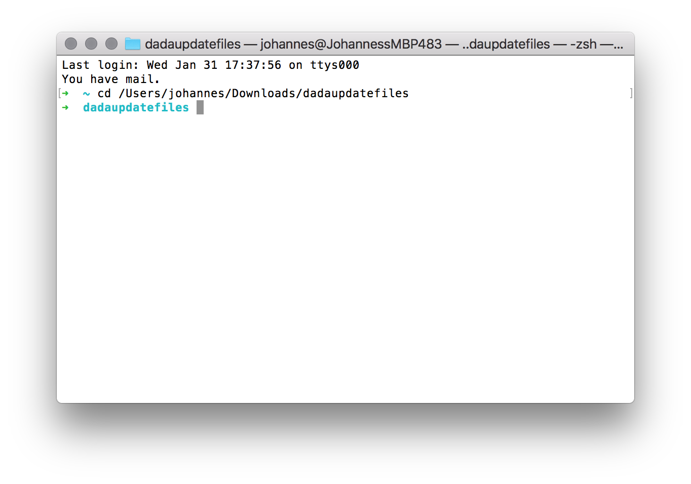

NOW hit Enter
- Now you should be inside of the Folder on the Commandline / Terminal

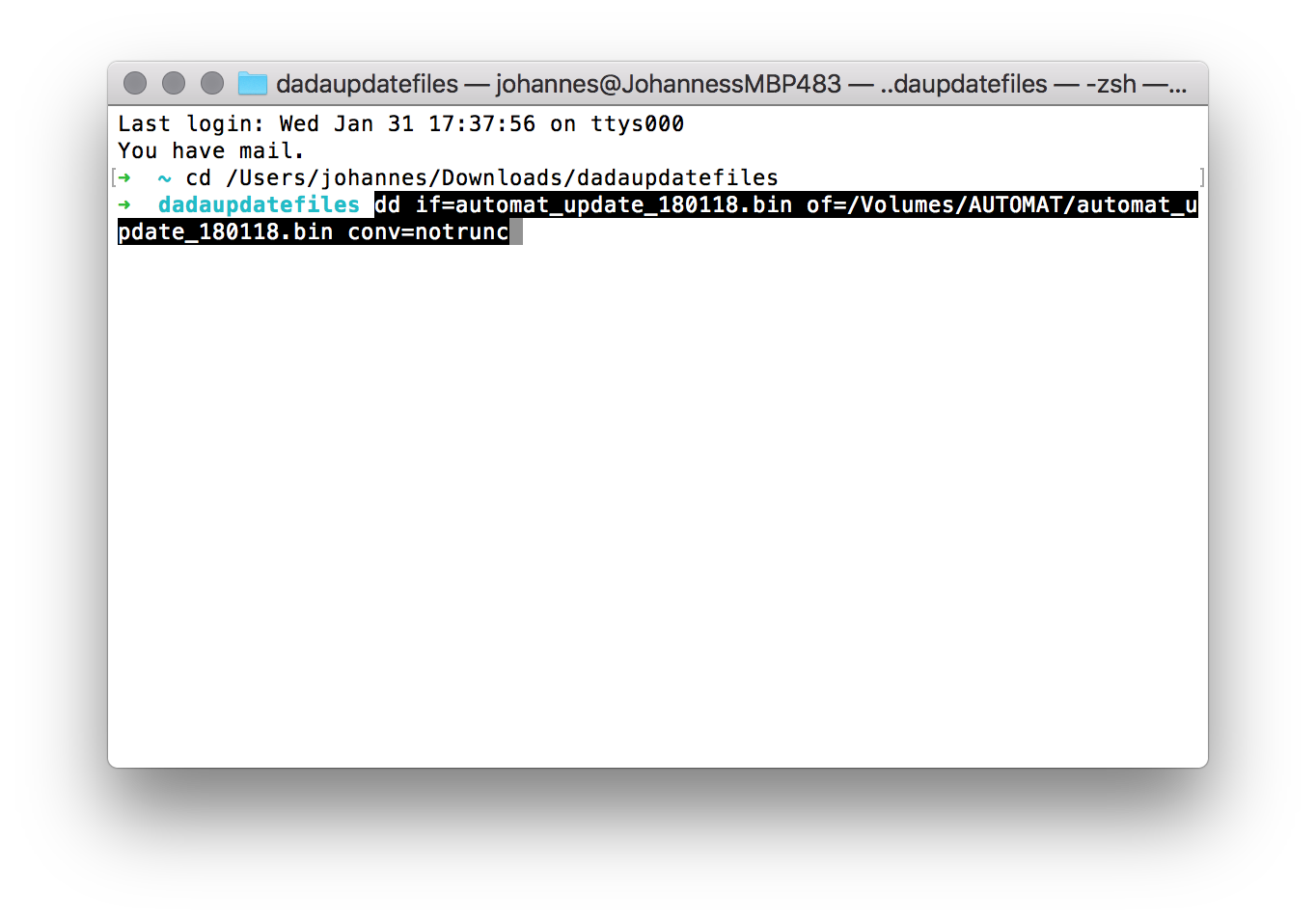

- Now you can copy the following Command to the Terminal Window

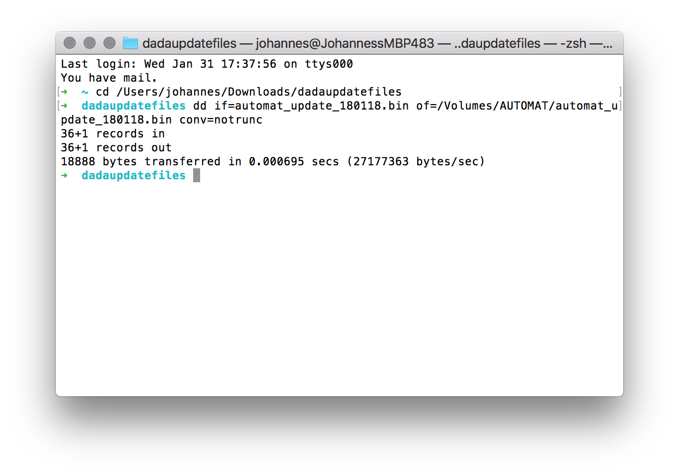

dd if=automat_update_180219.bin of=/Volumes/AUTOMAT/automat_update_180219.bin conv=notruncNOW hit Enter
- You will see something like this:
Now please and this is IMPORTANT use the Arrow Up Key on your Keyboard inside the Terminal Window to go back to the last Command and hit Enter again. (do this like 5 times)
